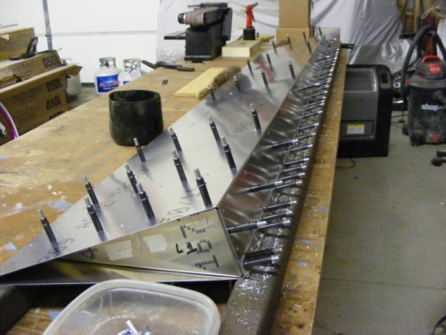

Finish L/H flap drilling
Layed out rivet pitch per drawing on hinge
drilled and cleco'd to flap
Dis-assemble to deburr

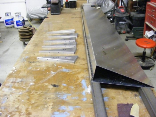

Layout rivet pitch on hinge
Hinge drilled to l/h flap
disassembled for deburring
