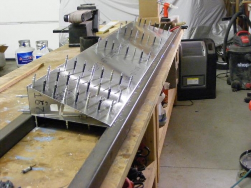

Starting L/H flap

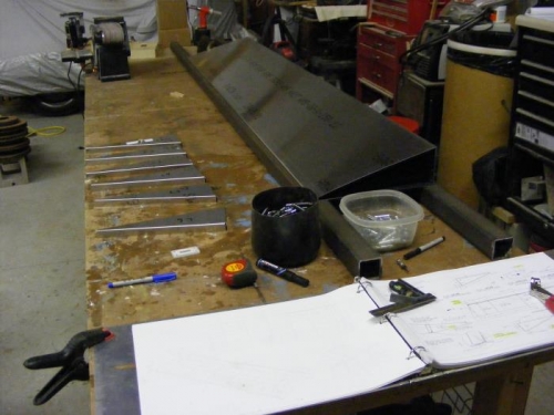

Starting the L/H flap. process is a mirror of the R/H side

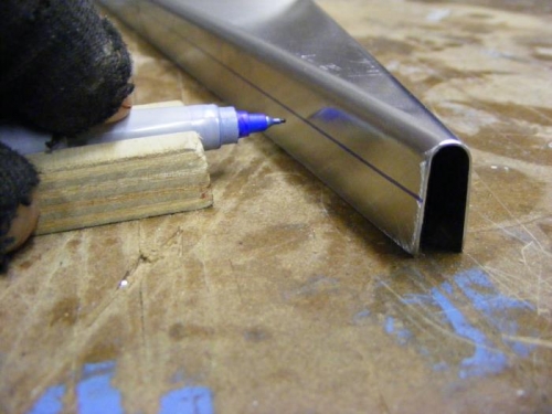

mark rivet lines on ribs
position inside skin, drill and cleco
enlarge holesfor a5 rivets.
I made the little plywood block to hold the sharpie for drawing the rivet lines. I just slide it across the work bench
Left flap parts laid out.
Rivet line marking tool
Left flap updrilling for a5 rivets
