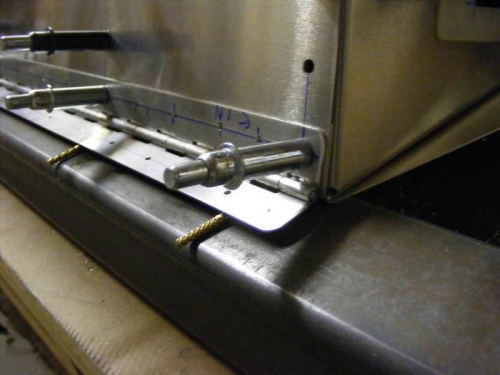

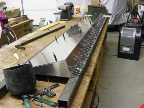

Brief Description:  DRILL FLAP HINGE TO FLAP
I used some .120" router bits as spacers to set the hinge position.
drilled the rib positions first to #40, cleco'd, then drilled all the other holes.
then drilled all the holes for the A5 rivets.
Now, time to take everything apart and start beburring
SPACERS TO SET POSITION
