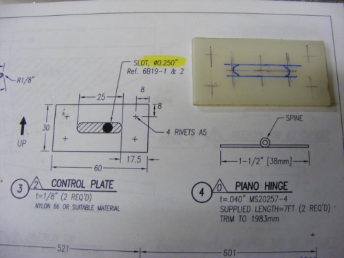

Brief Description:  Flap Control plate
Layed out the cut / drill pattern on the control plate.

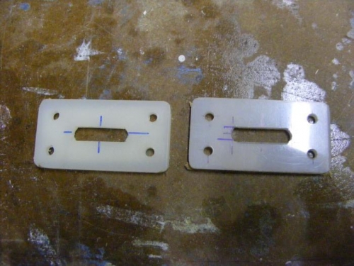

Used a single flute router bit to cut the slot.
Verified it fit tight on the pin of the flap control arm, and would slide to each end.

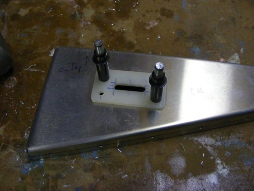

Layed control plate on inboard rib and used a sharpie to mark the pilot hole and
slot locations.
drilled 1/4" holes at end of slot in rib and used a round file to make the slot
placed control plate back on rib and drilled rivet holes to final size
Control plate layout
Slot cut and holes drilled
Control plate on inboard rib
