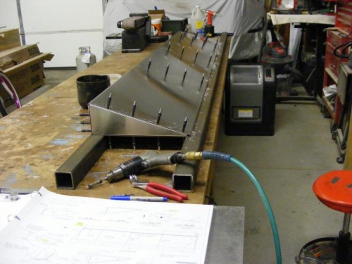

After many years and months, we're back to building. All tail surfaces are built.
Going to build the wings first, then the Fuselage.
Starting with the flaps.

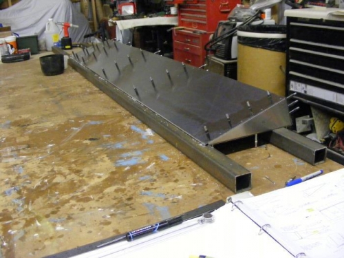

Simple flat construction on the rails.
Pre-bent skin, 6 ribs, hinge and nylon block for flap control arm slot and rivets
Marked rivet line on ribs
Aligned ribs with pre drilled holes in skin, drilled and clecoed to leading edge.
Squared up skin flat on rails, and aligned rivet line on ribs through predrilled holes in top skin.
Drilled and cleco top skin
Flipped flap over and drilled all holes on lower skin.
Verify flap is straight/flat on rails
