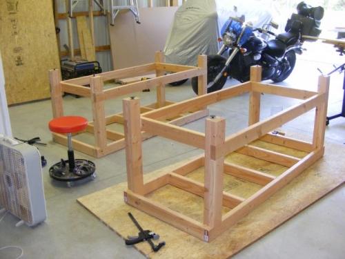

I used two layers of MDF for the counter top.
Even with building the frames on the floor, when flipped over they did not stand straight and level.

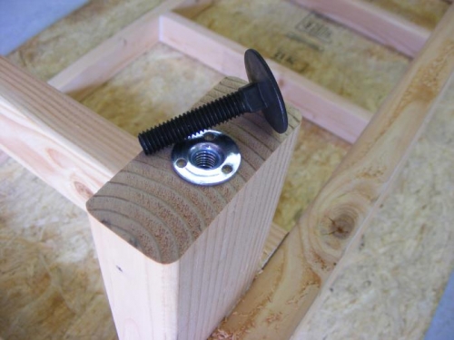

I added these adjustable feet instead of trying to trim the legs to match the uneven floor
adding adjustable feet
T nut installed
Adjustable steel foot
