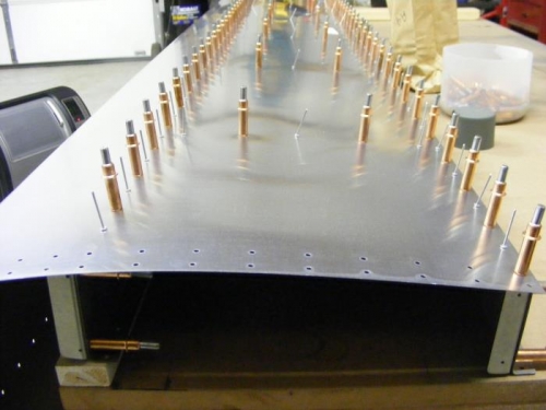

Horiz. Stab Bottom Skin install
Cleco's in every other hole

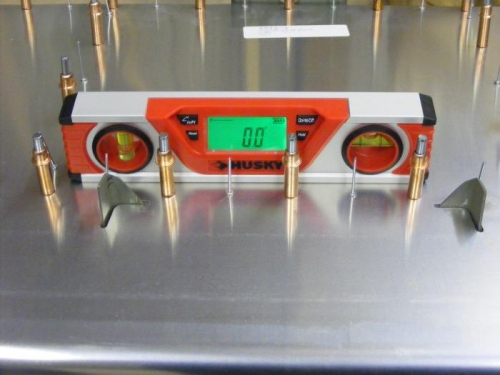

check for twist
Pull half the rivets
check for twist again
bottom skin cleco'd in place
rivet in every other hole
Verify alignment / levelness
