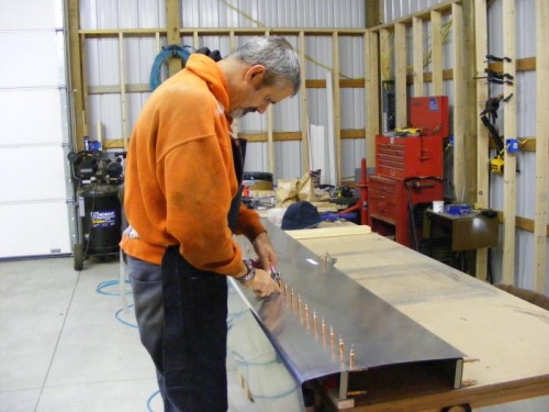

H Stab Drill and skin fit
Completed final size drilling of all frame holes

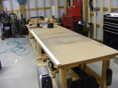

double sticky tape holds spacer to table
set frame on spacer for proper alignment
fit the skin and cleco to spars
Verify everything is still square
final drilling of frame
Spacer for skin fitment
cleco skin on
