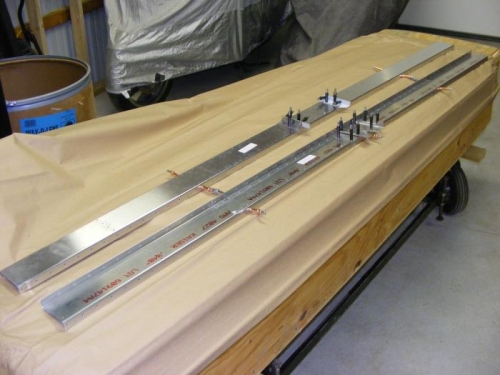

stabalizer spar sub assemblies
Fitting all the doublers and L brackets on the end.

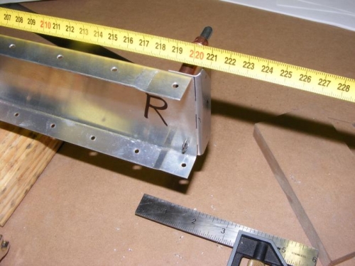

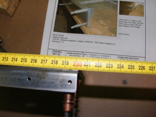

Verify predrilled details match drawing dimensions when assembled
Distance between end brackets is 2205mm.

End brackets clecoed on
Verify Dwg / Assy guide dimensions
