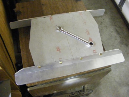

Engine prop flange stand
Bolted the support angles onto the engine stand plate
These angles will provide clearance for the nuts & bolts used to hold the engine against the stand.

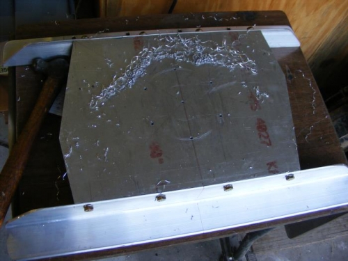

Drilled holes to match prop flange pattern

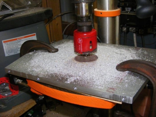

Cut center hole to clearance center boss on prop flange
Angles bolted on
holes drilled to match prop
Cutting center hole
