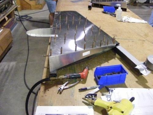

Brief Description:  Final riveting of the Rudder at Workshop

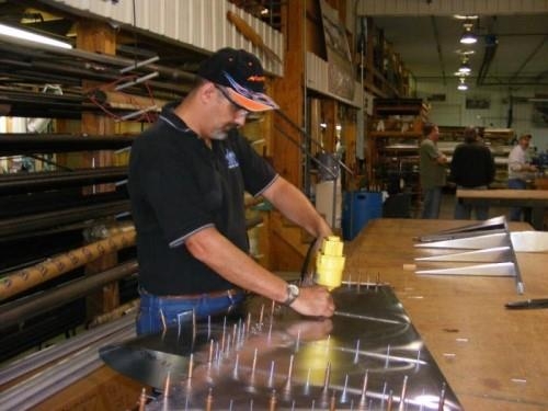

All details were prefit, deburred, corrosion protected and then riveted together. I was skeptical of the "pop" rivets at first. But according to the data sheet they do have a higher shear rating than a solid rivet. We're trying to finish everything up so we can enjoy the rest of the "Open Hanger" day festivities. Demo rides are next!
Fitting the Rudder Skin

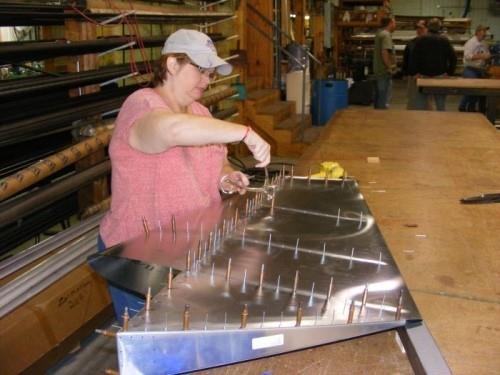

Half riveted, trade clecos for more rivets
Almost done with the rudder
