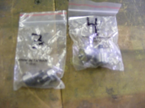

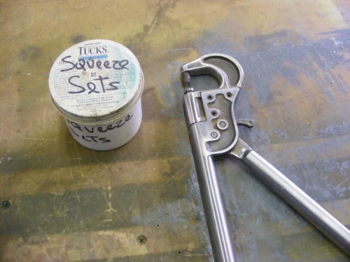

I needed to rivet the stringers around the access hole in the rear bottom skin.
Material is too thin to countersink, so dimples are required in order to install flush rivets.
I didn't want to use the standard pop rivets for the stringers because I didn't like the idea of the cover being screwed down on top of the rivet heads.
Hand C-Squeeze
Hand C-Squeeze
Dimples for #3 & #4 rivets
Starting to Squeeze dimples
