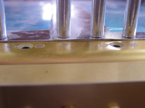

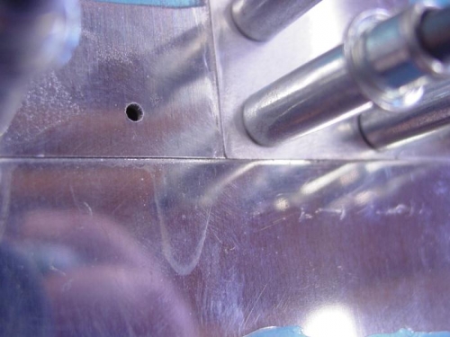

Brief Description:  Wing Skin Overlap
Started working on the top wing skin overlaps. I really felt uncomfortable removing skin material, but I guess it came out ok in the end. I decided that I was going to proseal that joint when I assemble the wings anyway. I know that means there will effectively be only 1 giant skin on the wing top, if something happens to that skin the whole thing will need to be replaced.
