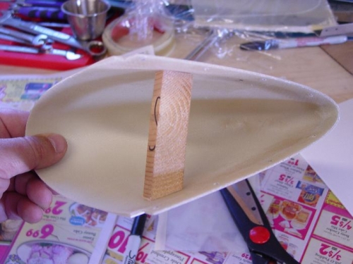

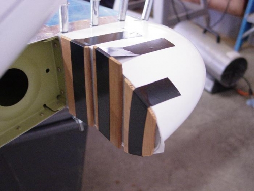

Fabricated the aft surfaces of the fairings. To do this, I first made a layup of a single layer of BID glass and let it cure on a perfectly flat surface. This creates a flexible piece that will conform to the shape created on the HS fairings. I cut some spacers so the fairings were in the proper position while I attached the aft surface and laid in a bead of epoxy/cabosil. I then attached to the HS and VS so that while curing the shape would be right.
