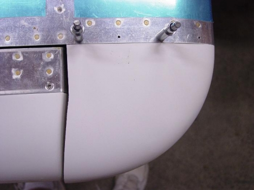

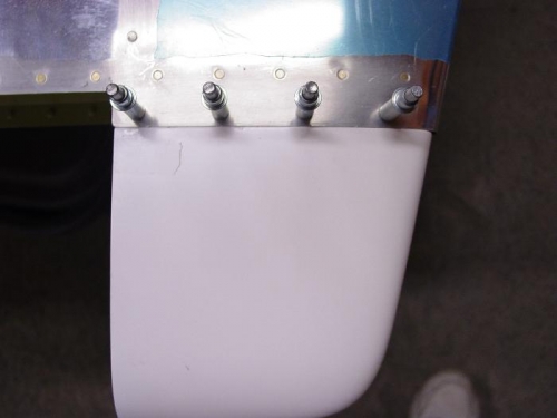

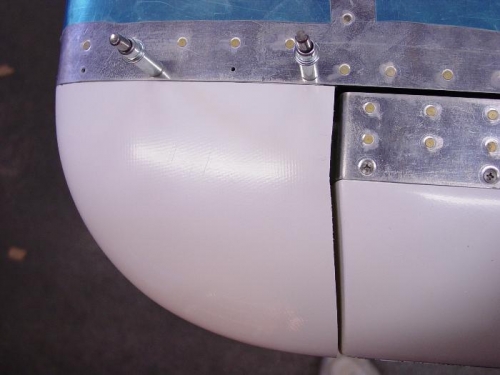

Brief Description:  HS, VS Fairings
Started working on the HS and VS fairings. This is different than the others in that the aft surface needs to be fabricated for these fairings. The first step is to remove material from the HS fairings to fit the shape of the elevators and their fairings. This is not a straight line as shown in the pics. My mistake was that I didn't leave enough gap on the HS fairings, when I added the glass to fabricate the aft surface, there was interference and I needed to redo these.
