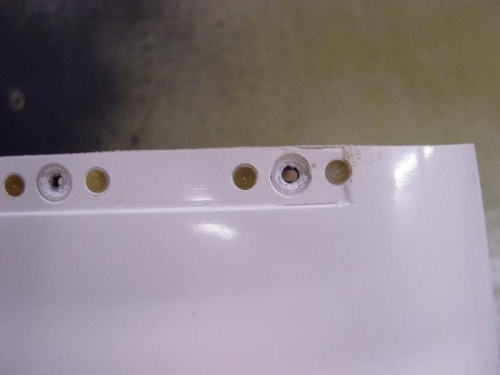

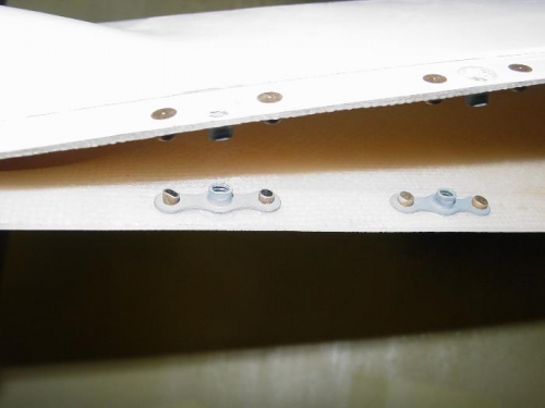

Brief Description:  Rudder Fairings
Rudder bottom fairing. Same technique as the rudder tip fairing. This came out better overall than the tip fairing. On the forward screw hole I should have used the nutplates with both rivets on one side, since the rivet hole overlapped the edge of the recess. When mounted it doesn't really show though.
