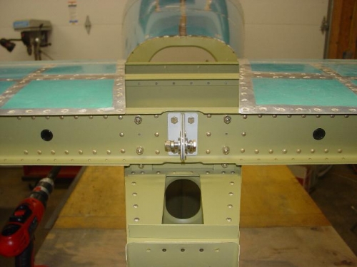

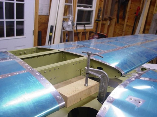

Got the HS set up on the tailcone. Match drilled to the HS attach bars. Got the HS squared up on the tailcone. Final measurements from the top of the tailcone (used one of the fairing nutplate holes in the center top of the tailcone) to the tips of the HS agreed within 1/16".
