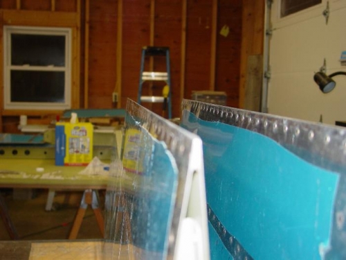

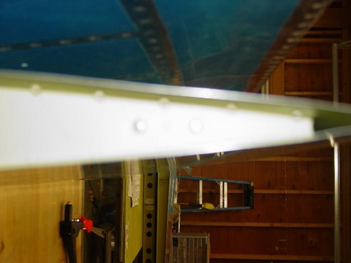

Riveted the trailing edge of the elevators. They came out great using the method I tried on the rudder. I squeeze the rivets first, partially setting them. I do every tenth rivet, then go back and set the rivet adjacent to these, and continue doing this until they are all squeezed. I make sure the squeezer is flush on the manufactured side, then set the depth so the other die doesn't touch the skin on the other side. Once this is done, I flip the elevator over and back rivet flush using the flush rivet set. I do every tenth rivet again to make sure there is no bend in the edge.

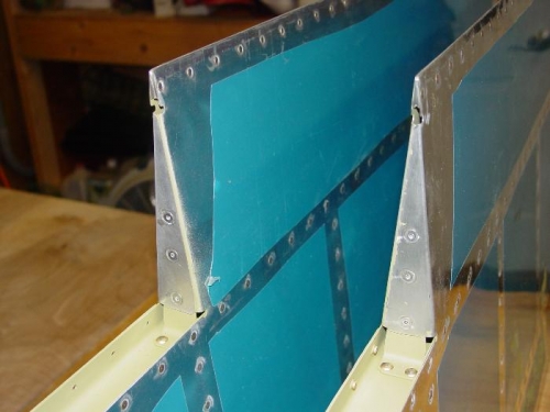

Finished riveting the skins to the tip ribs, and the shear clips to the close outs.
