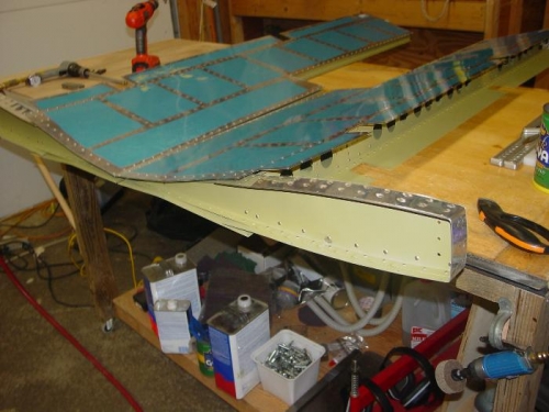

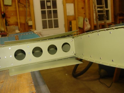

Elevator Assembly
Riveted the skins to the rib flanges on the inboard end. Clecoed the tip ribs on and riveted to the shear clips. Rivet the tip assembly to the front spar.
Pictures: DSC03591 - DSC03592
