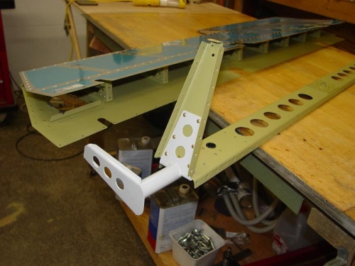

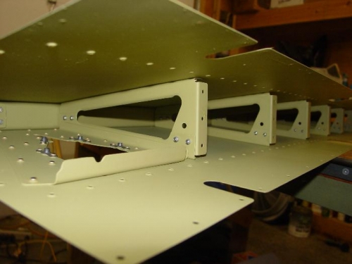

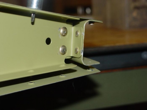

Riveted the front spars to the skins, except for the areas that allow access to rivet in the root ribs. Finished riveting the elevator gusset by lifting the skin. This was not easy, I have big hands but it was possible using the tungsten bucking bar. No idea what I would have done without it.
