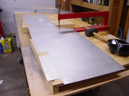

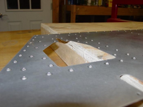

Elevator Dimpling
Prepped the surface for priming using the DA sander with scotchbrite pads. I always do this BEFORE dimpling, as the dimples tear up the scotchbrite. The pads go a long ways if the surface is smooth.
Dimpled the skins and counterbalance skins.
Pictures: DSC03557 - DSC03558
