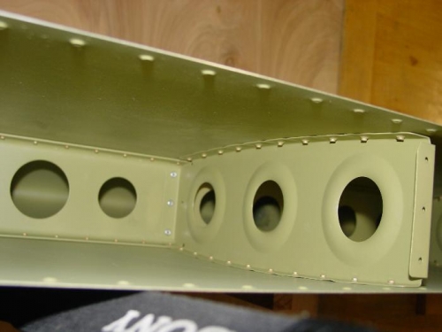

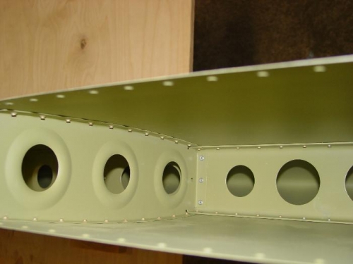

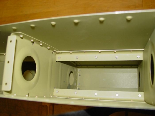

Manual Reference:  8-13-4 to 8-13-5
Brief Description:  HS Final Assembly
Finished riveting the stringers to the skins. The tungsten bucking bar was great for bucking the rivets that are hidden by the stringers. You kind of have to go by feel in that area, I would push my finger onto the bucked head and look at the size of the dimple in my finger to determine whether the rivet was fully set.
Riveted the the rest of the inspar ribs to the skins.
