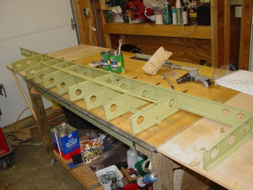

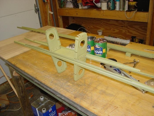

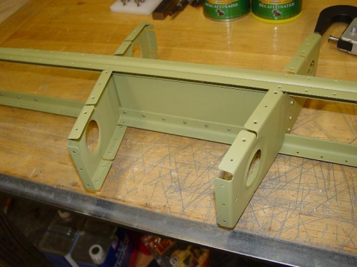

Riveted the stringer/stringer web/inboard rib assembly. Unfortunately I couldn't use the squeezer on the stringer web since the stringer flanges are too wide to get the squeezer over. The tungsten bucking bar does a nice job though.
Got the inspar ribs clecoed in place and ready to rivet.
