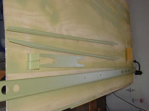

Brief Description:  HS Front Spar Priming

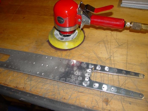

Got to try out my new tool for priming surface prep. It's the Taylor pneumatic DA sander with the 5" velcro attachment for holding scotchbrite pads. It does a fantastic job on larger pieces, but on small pieces or inside the curved flange of the spar the scotchbrite tends to fly off. Taylor makes a 2" version (that costs twice as much-go figure) that I may pick up for smaller parts.
Got all the parts primed after surface prep/cleaning.
Pictures: DSC03509 - DSC03510
