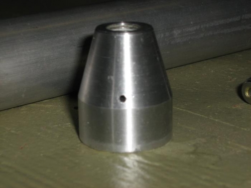

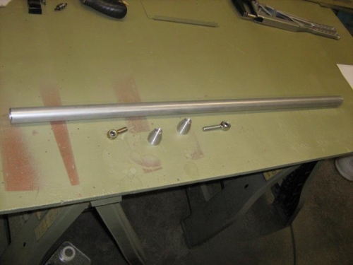

Worked on the short (fore) elevator pushtube. This one is interesting in that it has a safety wire. This required drilling a hole in the threaded rod end, apparently this is to prevent the rod end bearing from backing out, which would really ruin your day.
