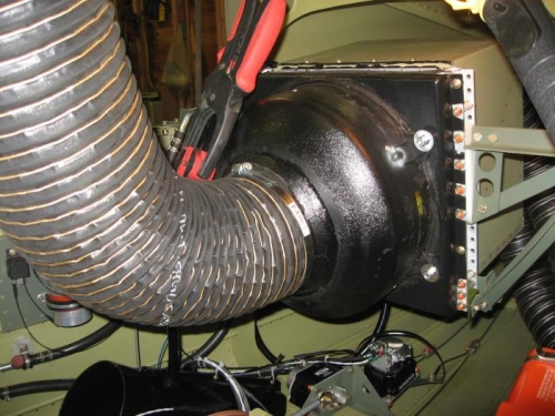

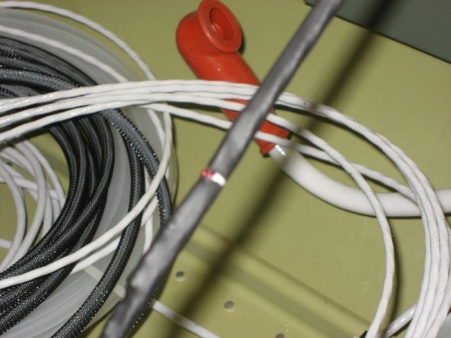

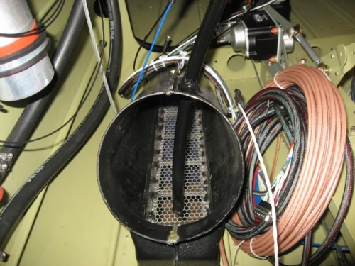

Condensation line.
Drilled a hole in the condenser outlet manifold for the condensation line and secured it with RTV. Finished wiring the LED for the ELT DIN connector. This is supposed to flash to verify that GPS data is being received by the ELT
Pics: IMG_1009 - IMG_1011.jpg
