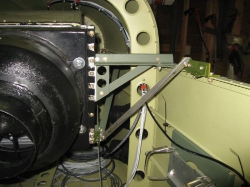

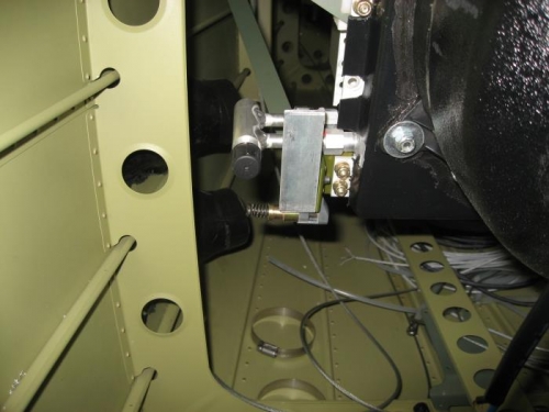

Worked on the front struts for the condenser. The right side was tricky as the hose attach is in the way, so I designed an offset bracket to avoid the interference.
Pics: IMG_0966 - IMG_0967.jpg
