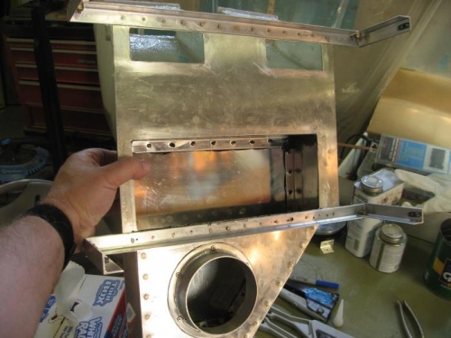

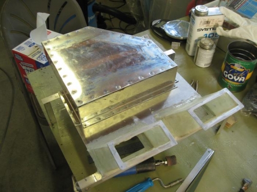

Brief Description:  Evaporater faceplate
Final assembly of evaporater faceplate. All the seams were sealed with the black Dupont RTV to prevent any air from the tailcone entering into the evaporater. The condenser circulation is very well sealed too to prevent the entry of CO into the tailcone via the condenser circulation.
