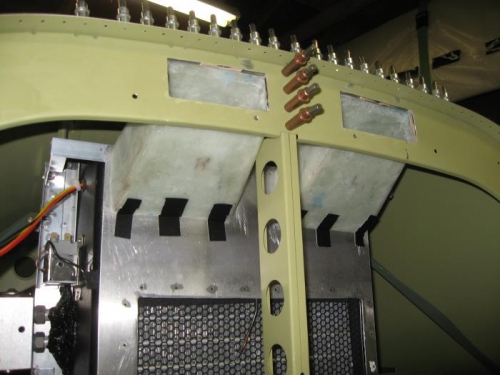

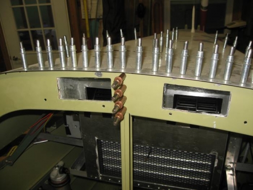

Brief Description:  Evaporater outlet
Fitting of the ducts to the space between the evaporater faceplate and the flanges that are adhered to the tailcone bulkhead. The concern is that the bulkhead is not very stiff and can move a little. This should be ok as the weather strip I will use should take care of small adjustments.
