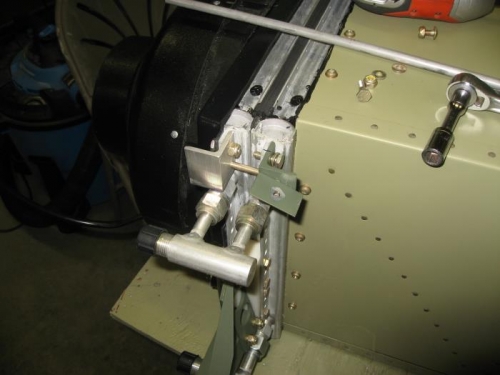

Brief Description:  Condenser mount
Started working on the lower condenser mount. I felt like there should be a solid connection between the two heat exchangers so there will be an angle on each one connected by a bolt with an aluminum spacer to allow a strong clamping force without distorting the flanges on the heat exchangers.
Pic: IMG_0904.jpg
