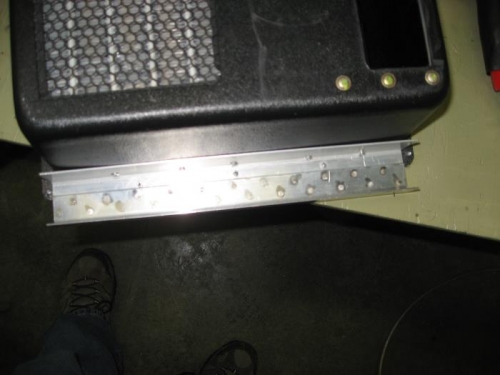

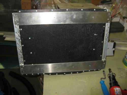

Brief Description:  Evaporater mount
Work on the evaporater mount. I had already mounted extra angle to the existing angle that came on the evaporater, the straps across the back will add a lot of structural strength. The evaporator will eventually be totally surrounded by structural aluminum as the plastic of the case doesn't seem like it would be strong enough for the primary support for the long haul.
