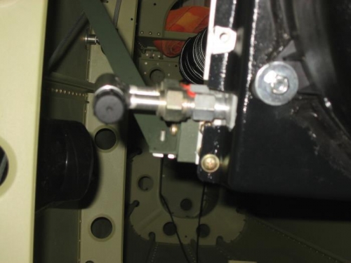

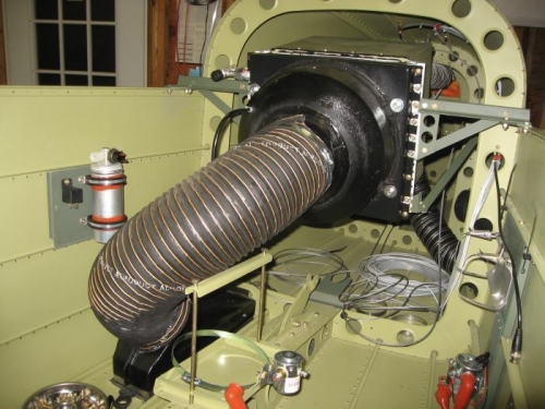

Had to rework the aft diagonal condenser support struts as they are now too long because of the rotation of the condenser. Somewhere around this time frame I decided to add fore struts as well that will make a solid redundant support for the condenser in the event the main support failed.
