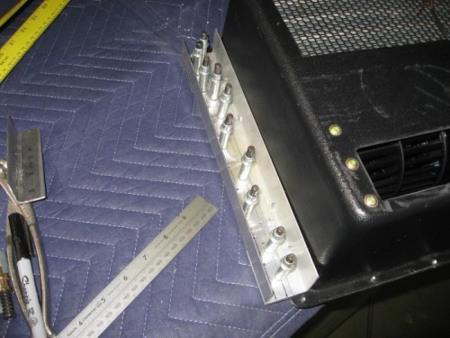

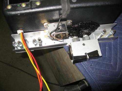

Brief Description:  Evaporater mount
More work on the evaporater reinforcement. I am adding a couple of heavy aluminum straps across the back of the evaporater to reinforce it. These will be attached with pulled rivets. I also am adding angles along the existing aluminum angles on the sides to produce a surface parallel to the sides of the evaporater.
Work done on 11/29 and 12/1.
