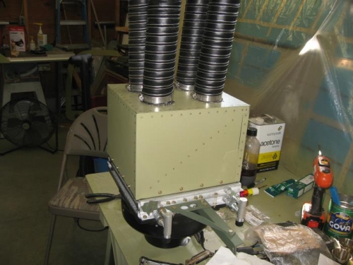

Brief Description:  Condenser plenum

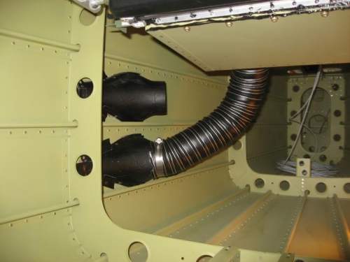

Cut the scat tube to length for the cooling air to the plenum. These were then bonded to the plenum using tank sealant, this will definitely be a permanent connection. At the naca scoop end I will use high quality silicone so that it will be removable if necessary.

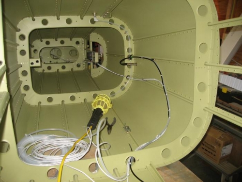

Also did some wiring for the ELT antenna. Once the condenser is mounted it will be impossible to reach the ELT antenna.
