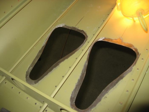

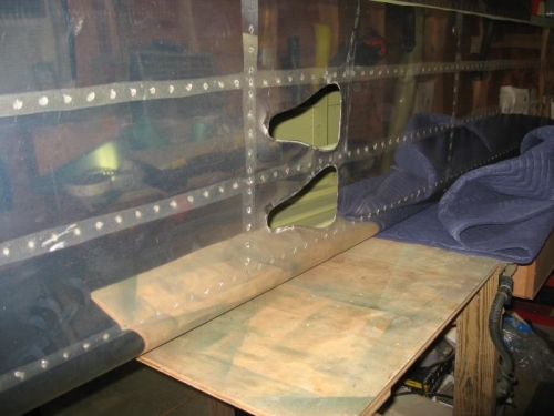

Brief Description:  Naca scoops
Finished cutting, shaping and deburring the scoop openings on the right side. I removed the primer on the border of the opening as the scoops will be bonded with thickened fiberglass resin. I bought some black dye for the resin so it would blend with the carbon fiber of the scoops.
