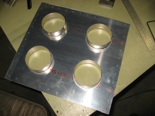

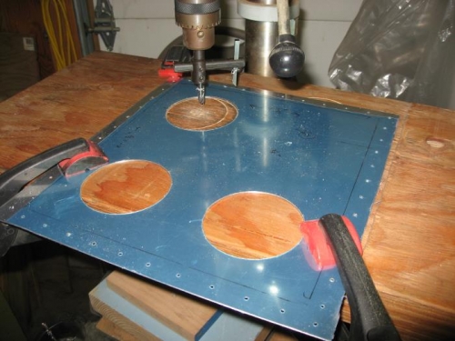

Brief Description:  Condenser plenum
Drilled the attach angles to the face of the plenum. Cut the holes for the hose attach flanges. This was done with a fly cutter which is a bit dangerous, the part has to be secured very well and the cut made slowly to prevent grabbing. Worked out well in the end.
