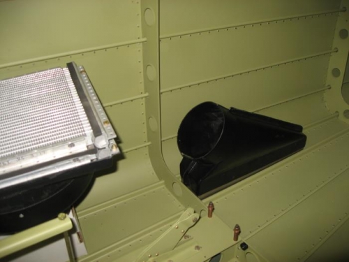

Brief Description:  A/C planning
Planning for the layout of the AC components. There is virtually no help from the company on this and there are no suggested layouts. I was originally looking at mounting the condenser horizontally as shown in the photo but after calling the company I found out that this is not possible, there is a top and bottom and there supposedly could be premature compressor failure if the condenser is mounted like this. Something about the lubricant in the system not moving properly or something like that.
