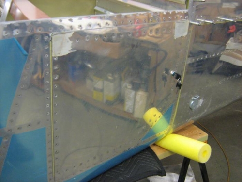

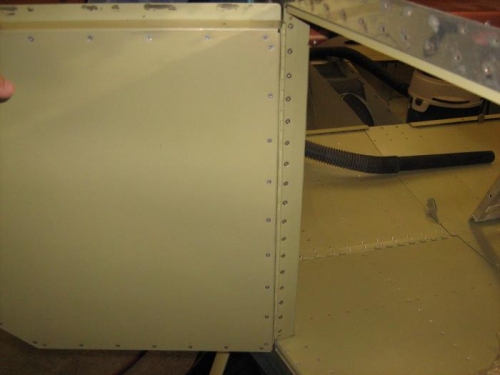

Brief Description:  Baggage door attach
Final assembly of baggage door to the door hinge frame etc. The door skin fits really well at the front edge, top edge and rear edge down to the angled part of the skin. The curvature of the skin makes the door stand out a little at the bottom, I will put a slight bend in the door skin to take care of this.
