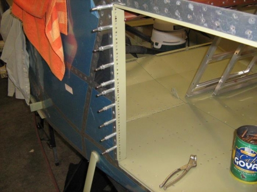

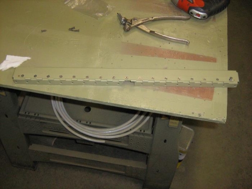

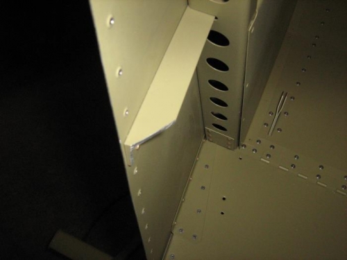

Brief Description:  Baggage door hinge frame
Checked the alignment of the nutplates with the baggage door hinge. Apparently the nutplate I used as a template to drill the holes was a little distorted and some of the holes didn't line up perfectly. Once I put all the screws in it was fine though. Prepped for riveting the hinge frame to the side skin. There will be some interference issues because of the nutplates but I should be able to get this riveted ok.
