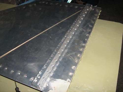

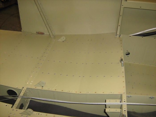

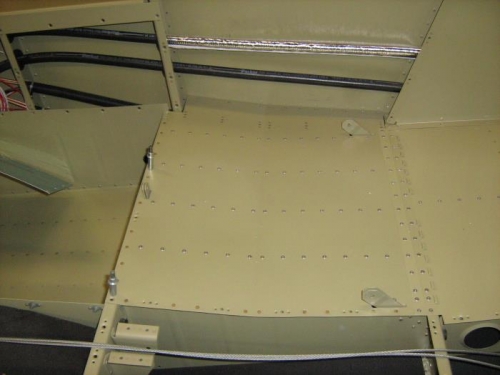

Drilled the baggage door hinge frame for nutplates. Countersunk the hinge for #6 screws. Finished installing nutplates and rivets along the baggage floor edges with the tunnel that I forgot to install earlier.
