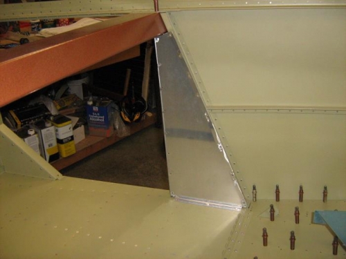

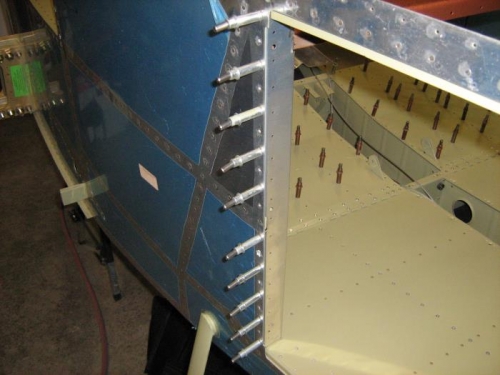

Drilled the baggage door hinge frame to the skins. I realized that with the alignment of the hinge to the side skin I can't see how the hinge pin can be put in. I will use screws instead of rivets to attach the hinge to the hinge frame.
