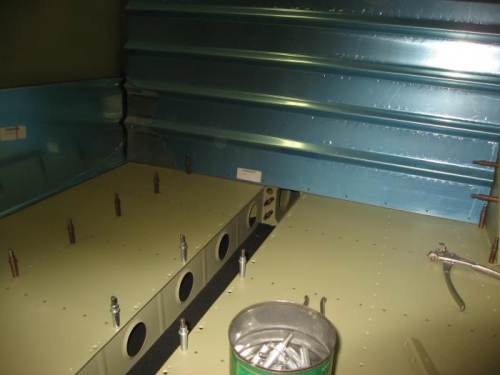

Brief Description:  Baggage area covers
Rough fitting of the baggage area side cover and the large corrugation. It was necessary to modify the lower right side of the corrugation to make a little more room for the A/C hoses that will be behind the side cover. I cut a couple short pieces of the two sizes of hose that will be back there and modified some grommets that will be mounted in the bulkhead to make sure everything will fit when I run the hose.
