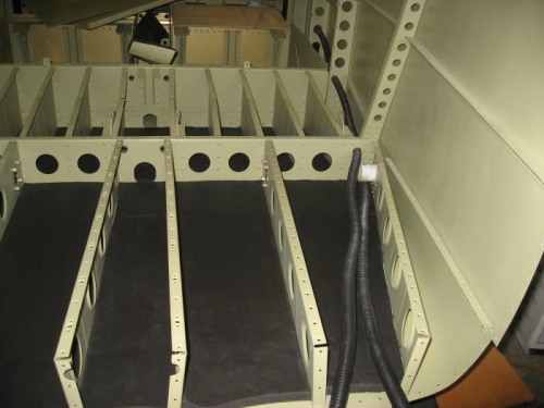

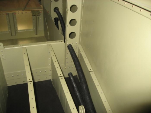

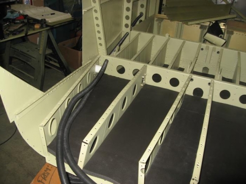

Brief Description:  Tailcone wiring
Installed the insulation under the baggage floor, except for the aft-most 5 inches or so which will interfere with riveting the tailcone to the fuselage. Ran the conduit for the wiring and static plumbing under the baggage area and into the wing root area.
