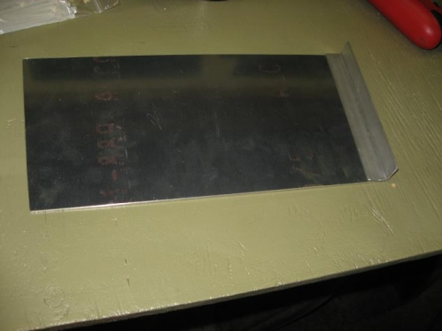

Brief Description:  ADAHRS mount
Started working on the ADAHRS mount. I'm using a heavy piece of aluminum as the base and sides, which will be riveted to the stiffeners on the top of the tailcone. It's about 12" wide though it will taper due to the taper in the stiffeners. I'm using 1/8" thick angle to make stiffeners. Probably overkill but I want this to be solid as a rock.
