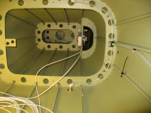

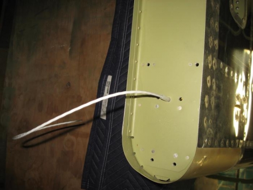

Brief Description:  Tailcone wiring
Took a long time pondering how I should run the wire for the aft nav lights. I decided to use a piece of static tubing as conduit from aft of the elevator trim mount. I also decided to drill a hole through the aft tie-down mount near the top so that there's no chance of interfering with the tie down ring. That was a lot of material to drill through especially with the vertical stabilizer mounted. This comes out below the bottom rudder mount bracket but above the top edge of the rudder bottom fiberglass.
