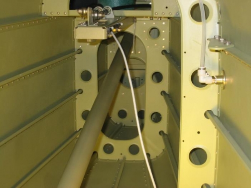

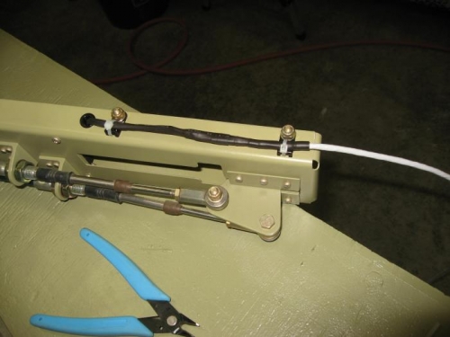

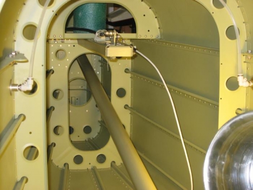

Tailcone wiring
Got the pins crimped on to the end of the trim wire and plugged in to the sockets on the trim motor side. Used a bunch of heat shrink to insulate, protect, and build up the diameter a bit to make it stiff to protect against vibration.
