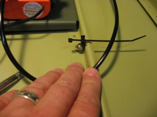

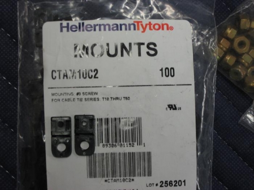

Brief Description:  ELT and antenna mounts
Found some nylon cable tie mounts to use for cable runs that aren't in a conduit. I use a #8 bolt and lock nut to attach these to the stiffeners. For some orientations like the one in the picture I drill a #40 hole to put the cable tie through. Seems to work great, hope they last for 35 years!
