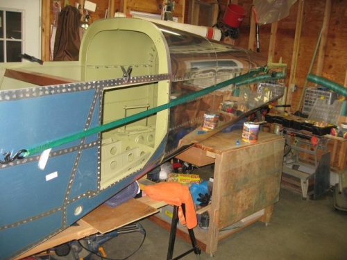

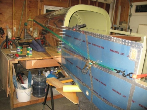

Brief Description:  Tailcone bulkhead drilling
Drilled and dimpled the F=1006 bulkhead. Tried to get the tailcone lined up to attach to the fuse for drilling. This was a bit tricky, it's really a two person job but I had enough ratchet straps to reach around everything to help hold it together while I jiggled things and lined up tabs and skin overlaps etc.
