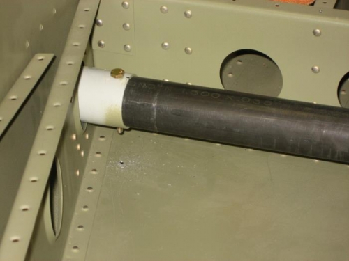

Brief Description:  Step intallation
Drilled the steps to the final size, but the left side especially had a bit of slop due to the inability to get everything lined up perfectly while drilling. I decided to drill the steps out to 1/4" and use an AN4 bolt instead. I needed to borrow Kerrys right angle pneumatic drill to be able to do this.
Steps were primed later on and are ready to install. This will be delayed as long as possible since they will be in the way when walking around the plane.
