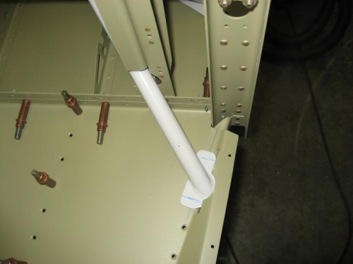

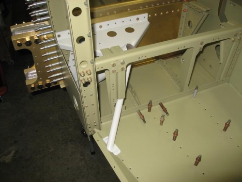

Brief Description:  Gear mounts
Temporarily install and set up the gear mounts for drilling to the front floors. It was quite challenging getting all the bolts in for the gear mount and there was some interefence with the edge of the holes on the bottom skins that needed some enlarging.
